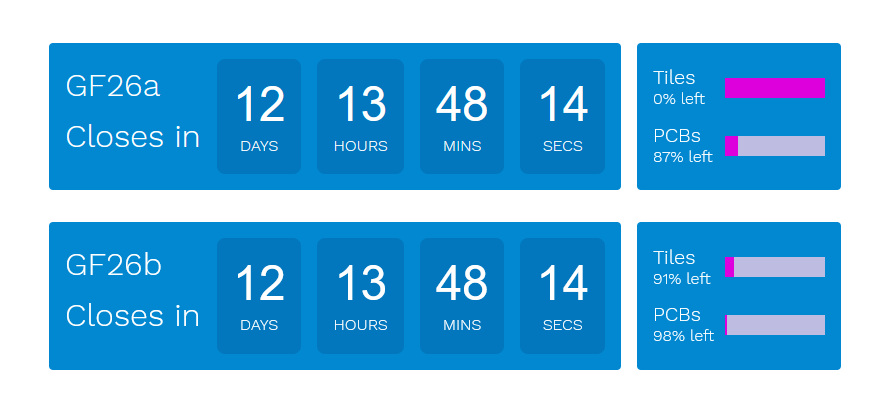

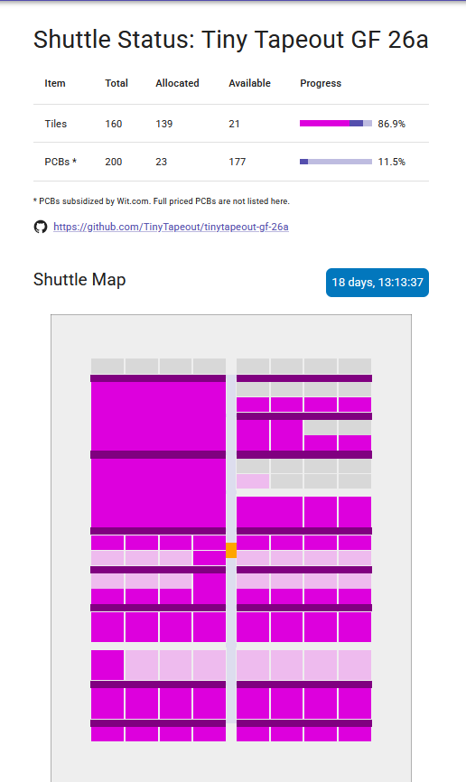

Looking like Tiny Tapeout may need a second slot 👍
tnt
@Andrew Wingate Repo already ready https://github.com/TinyTapeout/tinytapeout-gf-26b 😅
Andrew Wingate 2026-06-04 7:17 a.m.
waferspace Nice!! You guys should consider showing more Open Shuttles on your homepage https://www.tinytapeout.com/
Tiny Tapeout makes it more accessible than ever to get your designs manufactured on a real chip!
But they're not open yet 😅 ( As in, you can't submit it yet ).
💜 1
Andrew Wingate 2026-06-10 6:11 a.m.
100% filled!! That's awesome Tiny Tapeout Team!!!

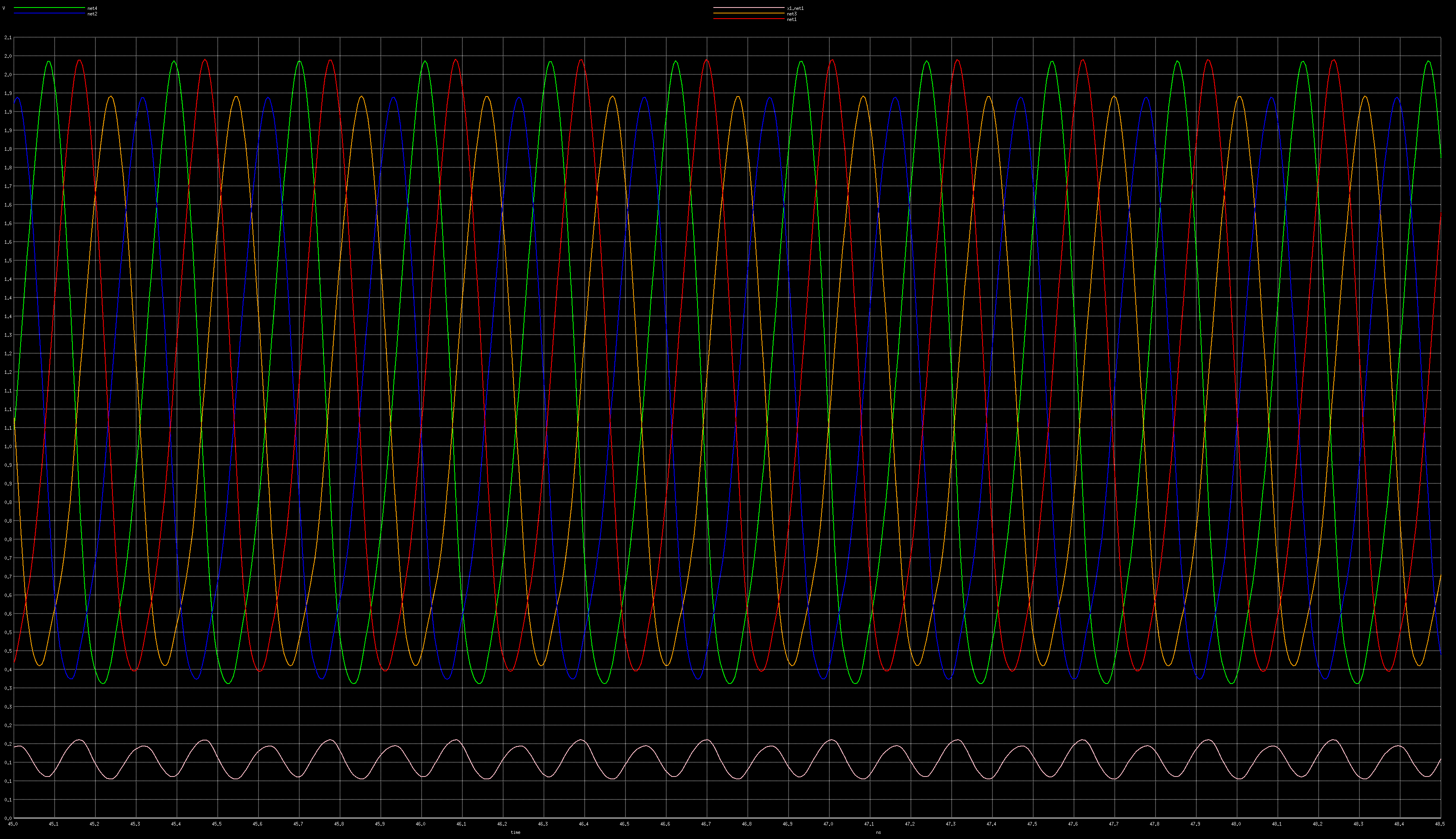

now that I'm no longer actively suffering from whatever that bread contained, let's hurry back to get this serializer worked on before anything is too late for it.
VCO core, with enough fingers to let me tap off a single-finger feed to a clock tree without this causing undue load, probably do be aiming at exactly the 2.5 GHz though, maybe probably better like 3 GHz to handle a bit of layout parasitics and process variation. Then clock buffer. Then a latch fast enough to accomplish a DIV2 off of this. Then a mux2 at least that would act as the final MUX in a C2 arrangement. Then draw at least a plain serializer MUX tree up to have a fallback to submit; the base clock buf cells should be sufficient speed. After, see how much time is left, and see how good an inductor would be needed to clock the input-multiplexed current-mode C4 MUX (the pseudo-nmos style architecture of it). If success, try to make an inductor that's good enough for pulling off a C4 architecture. If success, go and implement the C4 with FIR taps furnished at the CLK/2 level (i.e., C8). If inductor trials not success, instead go for some FIR taps at still CLK/2.

namibj

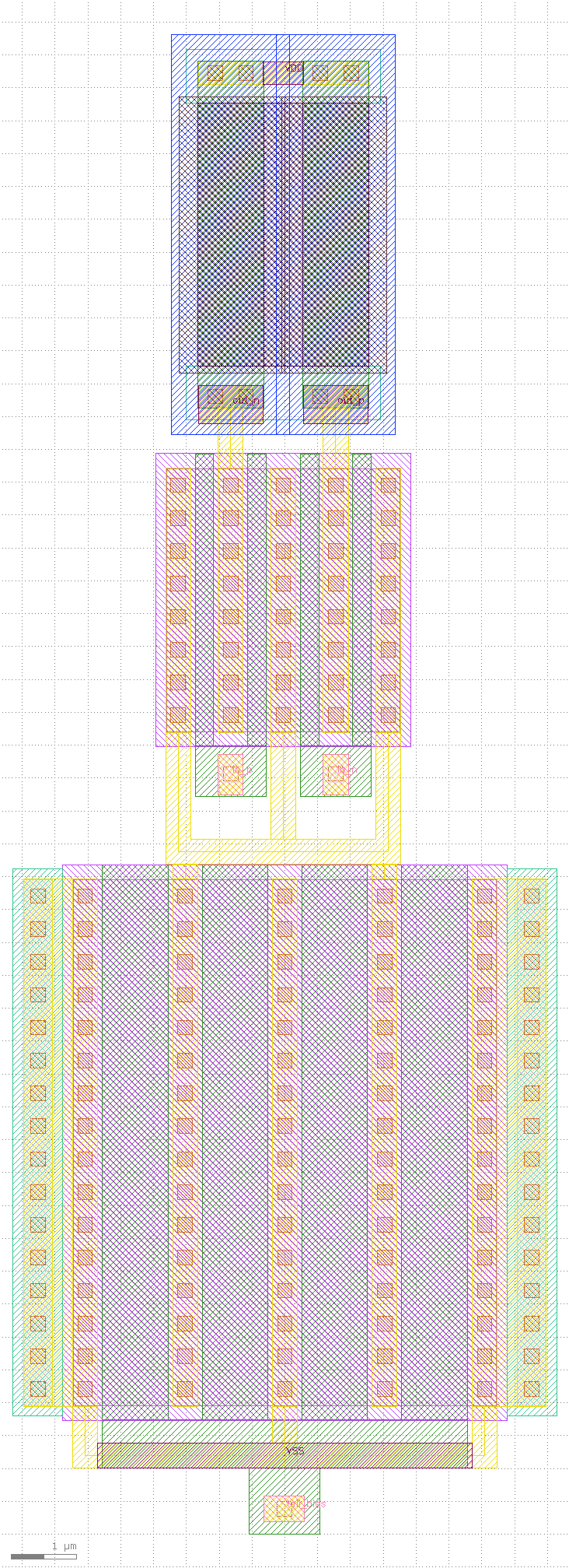

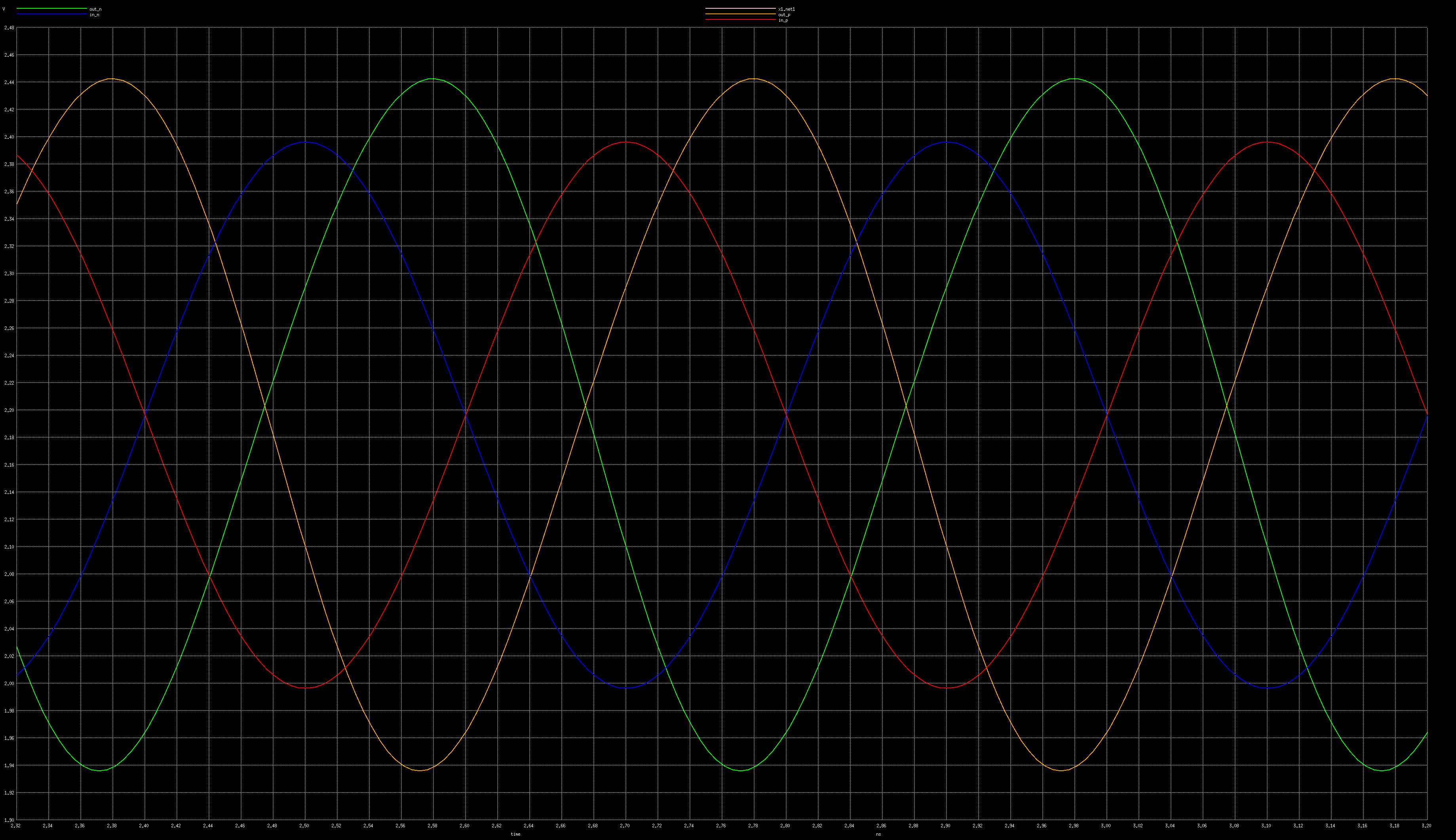

Oscillation success:
🏄 1
clock buffer at FO4, though with limited fancyness of harness

namibj

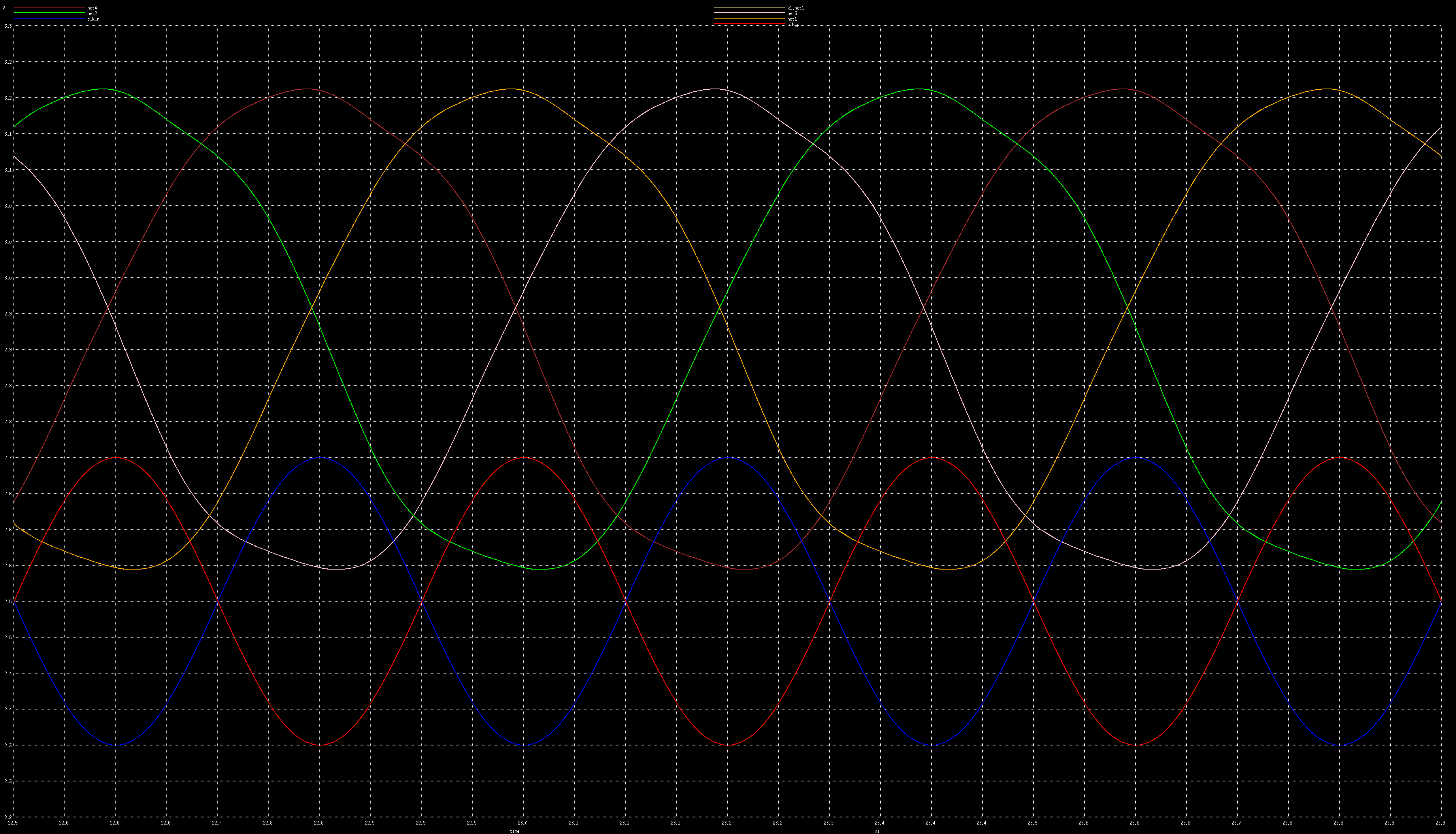

forward device's drain current density oscillating between approximately 16 and 72 A/m

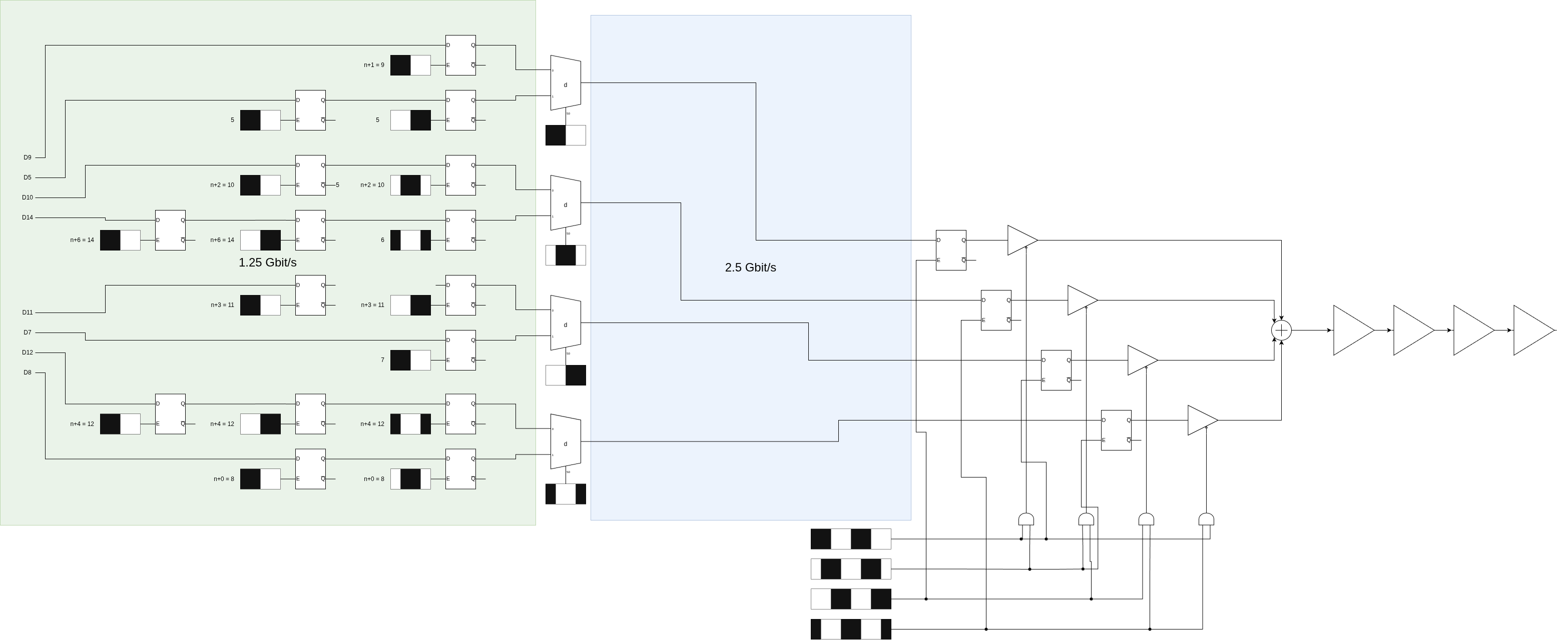

16 half speed latches @ approx 100 mW each + 4 full-speed latches @ approx 400 mW each + 4 full-speed MUX2 @ somewhere_between_those each, so a "total" of 3.6 ~ 4.8 mW, not counting the clock feed (quadrature phases at both full clock and half clock), and not counting the output predriver limiting amplifier (edited)
namibj
Click to see attachment 🖼️
yeah I don't want to draw the rest by hand, real ugly to tune that way....
Tim 'mithro' Ansell 2026-06-22 7:16 a.m.
How do you draw these diagrams? Just by hand in some tool or?
looks like draw.io to me
Hand in drawio.
11:34 a.m.
I'd prefer a less-hand way to get free verification out of it.
11:34 a.m.
I can send you the source this evening if you want.
namibj

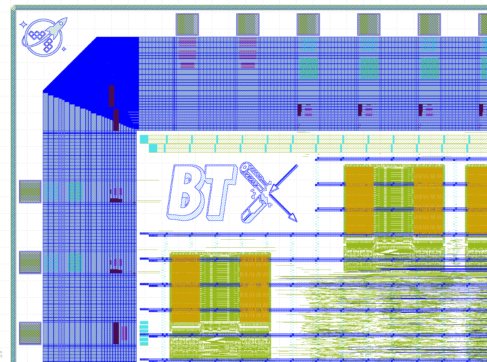

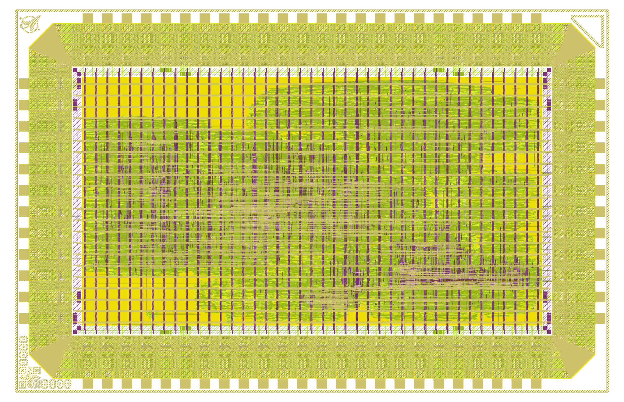

not perfect, but pretty happy how this turned out 🙂
💜 5
BreakingTaps
Andrew Wingate 2026-06-30 2:21 a.m.
Looks great!!
