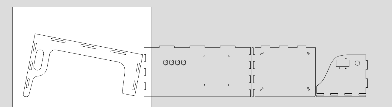

can you help john get onshape box model for cutting
im at Tims. John is going somewhere tonight where ther might be a laser
Andrew Wingate 2025-04-29 2:12 a.m.
I was already doing it
thank you!
nominal material thickness is 1/8" I can change it if needed
if it is less, like cereal box cardboard, that's fine right? the tabs won't be snug, but I can sitll goop hotglue all over the plance it will mostly work
Andrew Wingate 2025-04-29 2:33 a.m.
I mean, I can change the thickness, so if it's as thick as cereal box, it's fine. tab sizes will just auto-change too
in case John is short on time and grabs whatever material is handy, wnated to make sure thinner is ok
3:04 a.m.
thicker I will have to turn the holes into notches - no biggie
Andrew Wingate 2025-04-29 3:07 a.m.
just lmk, it's all parametric

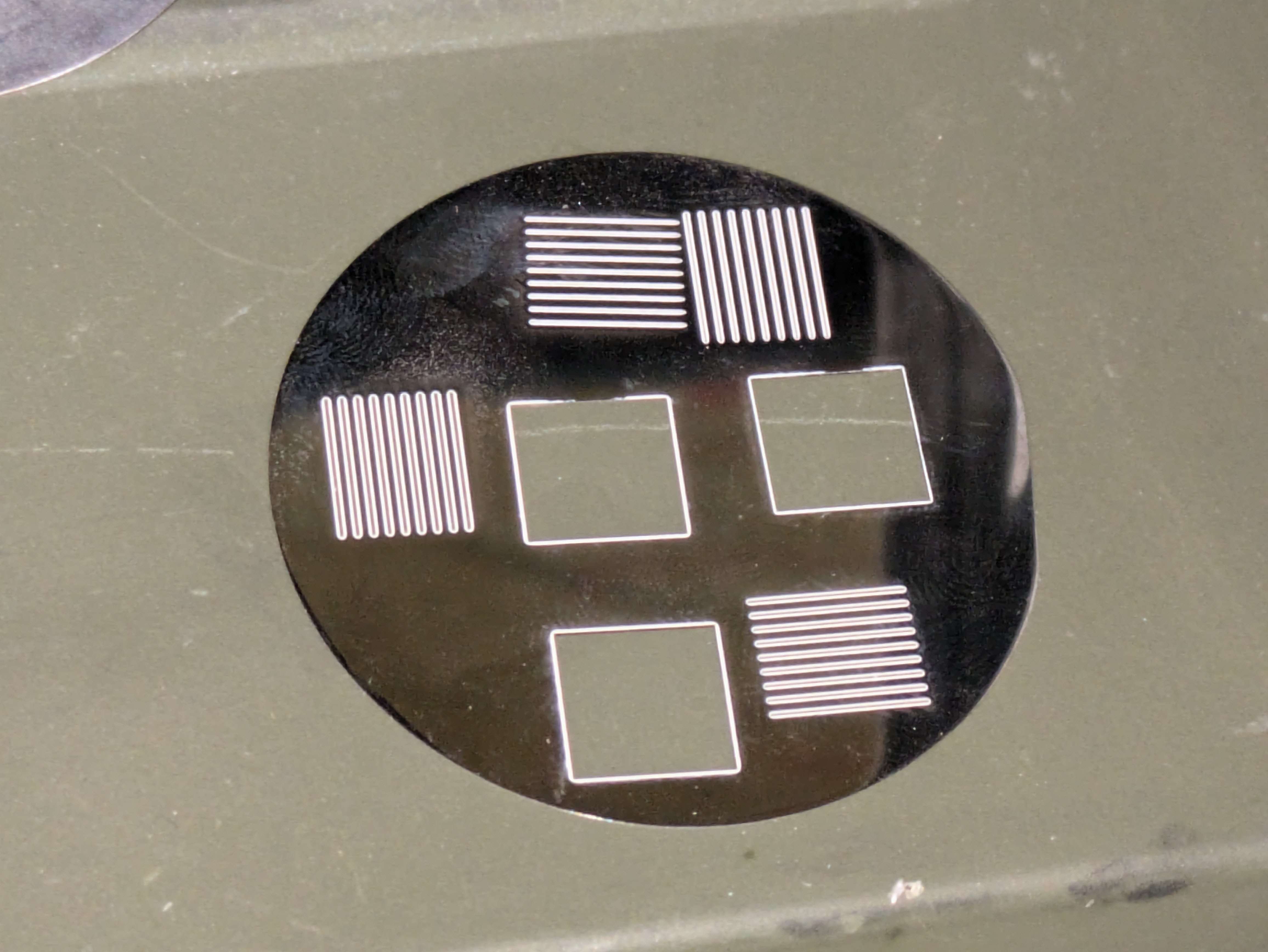

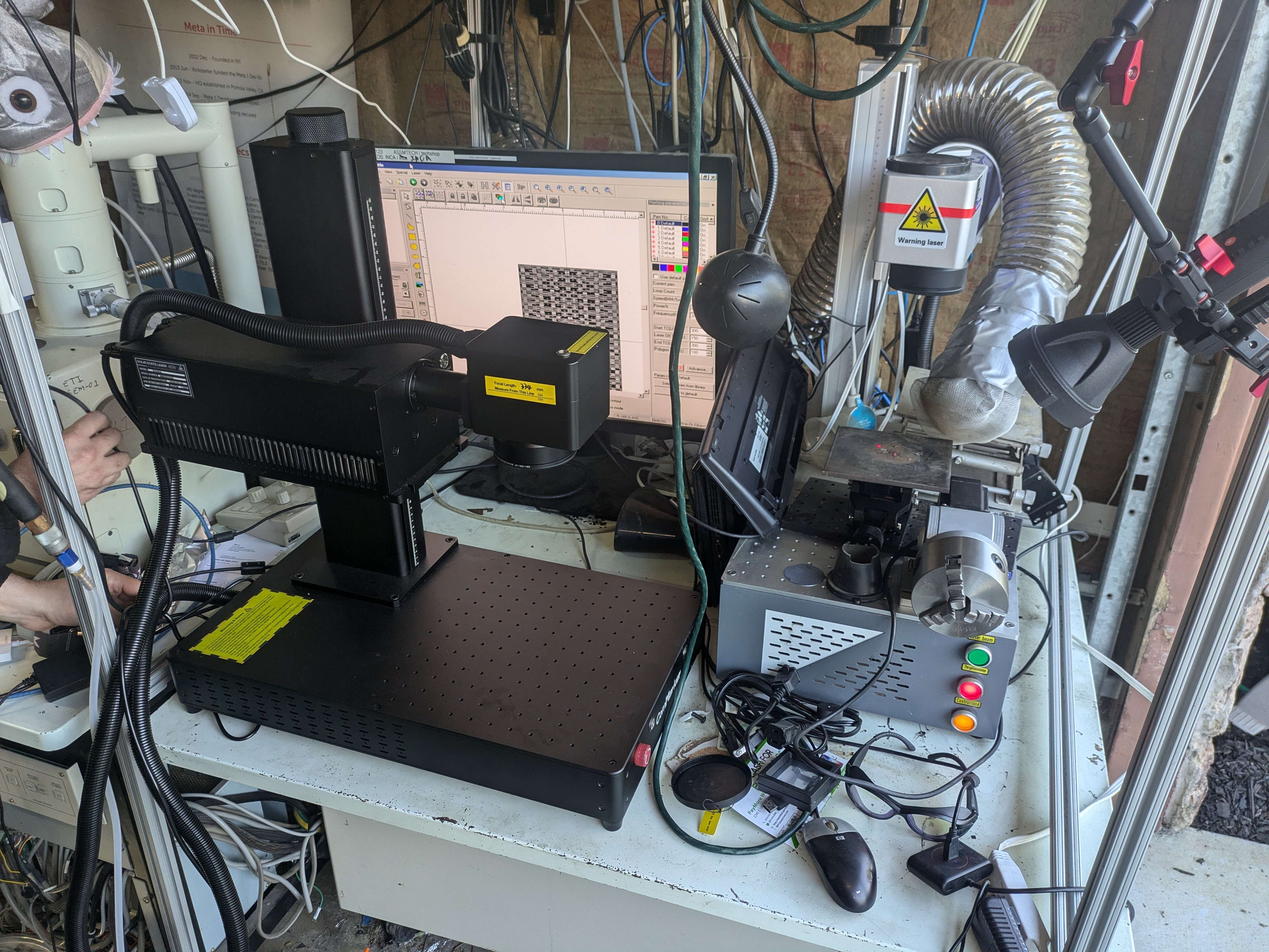

Experimenting with laser dicing. 355 NM mopa fiber
6:19 a.m.
We ran a bunch more tests. Maybe slightly better results with the 355 but not enough to justify investments so far
6:20 a.m.
I did get a lot better with the software options and might be able to improve my 1064 nanometer flow. Some evidence also suggest that I don't have my existing 355 nanometer fiber laser setup ideally, so I might also give that another pass
