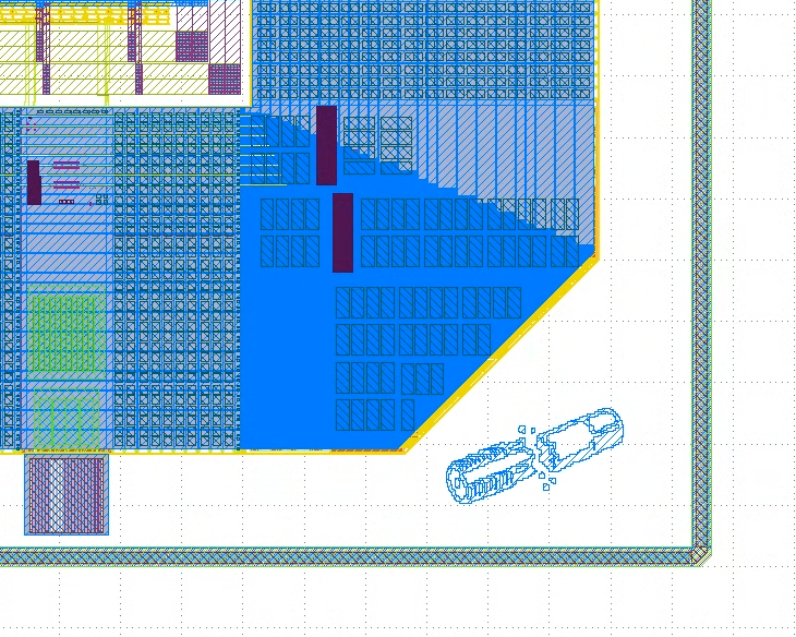

Can i add custom chip art on the top and bottom right corner ( similar to the wafer space logo and qr in the left ) ? Or can i only add inside the pad ring ?
Deepak
yep, you can! I have a little image on the bottom right of mine. I think the top right may be reserved for an arrow this time around (to help the wirebonding alignment) so I think we can't use that corner
BreakingTaps
Hey sure got it thank you much Will use only the bottom right
Leo Moser (mole99) 2026-07-01 6:27 p.m.
You are also free to replace the wafer.space logo on the top left. The precheck only checks the bottom left and the top right, if you have CoB enabled.
