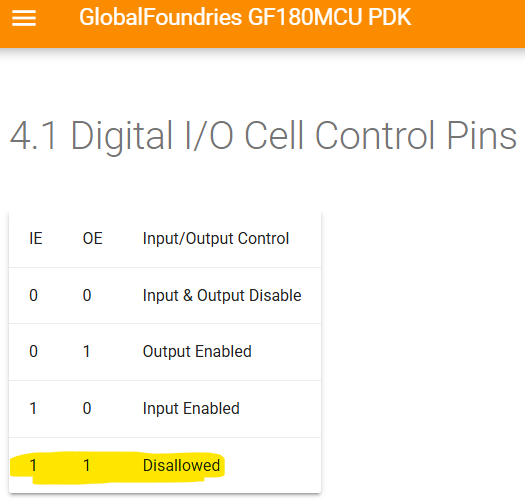

Any idea why is IE=1 and OE=1 marked as "disallowed"?
2026-06-08 6:31 a.m.
Yeah, that was a bit of a mystery but after reverse engineering the IO there is no reason that you can't have IE and OE at the same time.
6:31 a.m.
And we used them that way in TinyTapeout ( IE is always
1
and then we toggle
OE
as needed ) and they worked fine AFAICT.
