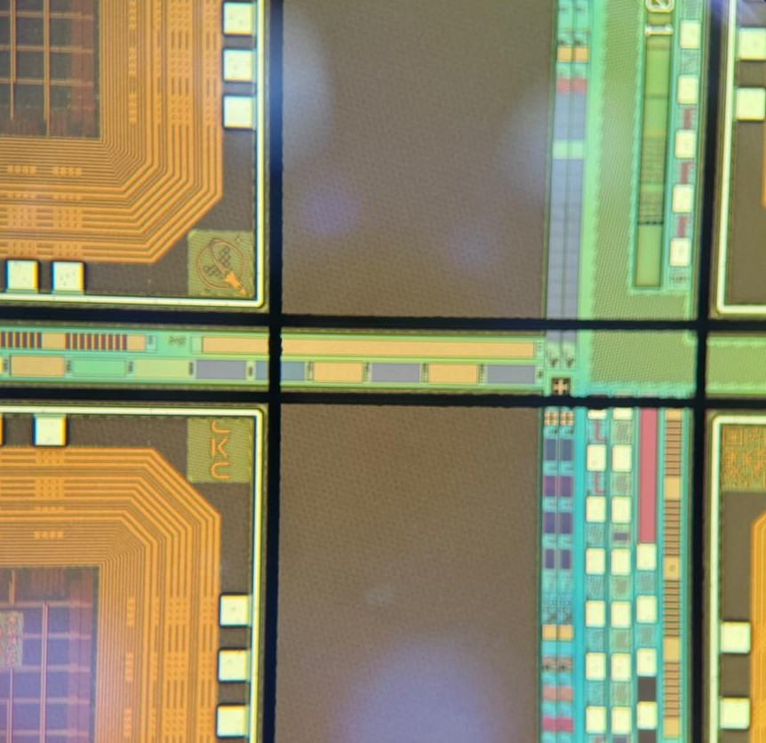

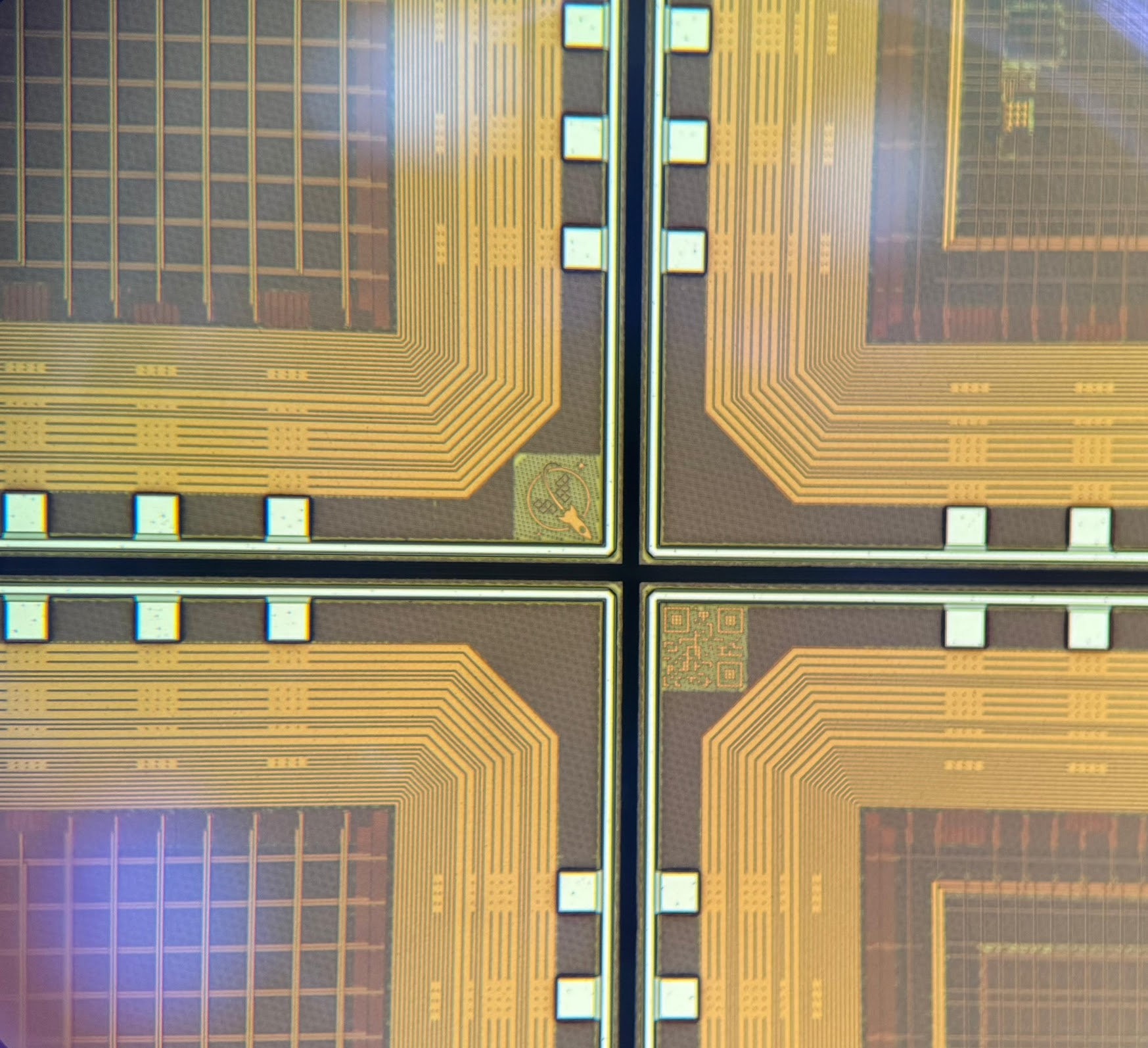

Share how close you manage to get to the scribe lines of Run1!
Tim 'mithro' Ansell 04/20/2026 12:12
The current scribe lines at 60um
12:16
Examples of the actual dicing -
