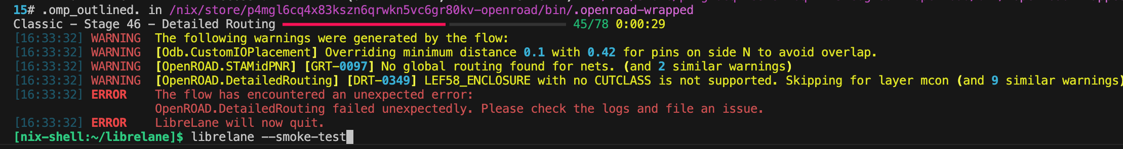

Thanks Leo! I am able to install librelane on my mac machine(nix based). However I ran into the errors below when I try to run "librelane --smoke-test" Should I ignore this and proceed with my designs?

That's really strange. Is an error shown above? You can try running the template, but I don't have much hope if the smoke test doesn't even work.
Yes, I also didn't expect that. I went to staight to the smke-test without changing anything after installation. So I really do not know how to fix it. Can you run the smoke-test on your end just to check?
Update: I tried the smoke test again on my ubuntu machine, it passed. But on mac I still couldn't get it to work
