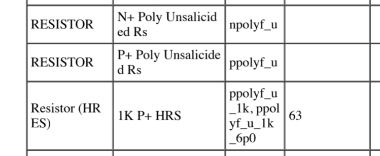

Which of the options for high res poly resistors is enabled for these runs? There is 1000ohm/sq, 2000ohm/sq and 3000ohm/sq and the note in the documentation says it can only be one of them.
Tim 'mithro' Ansell 03/20/2026 09:57
Leo Moser (mole99) 03/20/2026 10:05
@Tim Edwards Do you know if the runs at Efabless used the same configuration?
Tim 'mithro' Ansell 03/20/2026 10:27
@Leo Moser (mole99) - I believe I got that config from Efabless
Tim Edwards 03/20/2026 13:28
Yes, it's all what's defined in gf180mcuD or else I would have to make another PDK variant.
Ok so it's the 1000ohm/sq version available both in 3.3V and 6.0V if I read this correctly. Thanks everyone 👍
