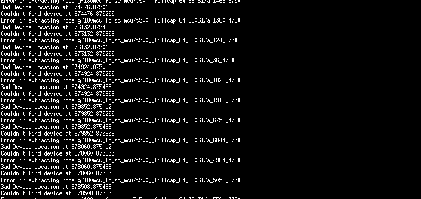

Error in extracting node gf180mcu_fd_sc_mcu7t5v0__fillcap_64_40578/a_3260_375# Bad Device Location at 585660,629620 Couldn't find device at 585660 629620

As for the "bad device location" error, I would need a reproducible result.
I can get the folder bundled up for you into a .tar.zst if you want, including the script that did that and the git commits involved in it happening.

Yes, please send me a tarball and I can look at it.

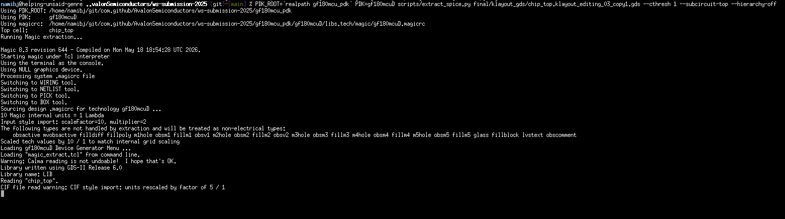

drc off gds read {/tmp/tmpk8ys6nzm/chip_top.klayout_editing_03.gds} load {chip_top} select top cell port makeall ext2spice lvs extract do resistance extract all ext2sim labels on ext2sim extresist simplify off extresist all ext2spice extresist on ext2spice resistor tee on ext2spice cthresh 1 ext2spice subcircuit top on ext2spice hierarchy off ext2spice quit -noprompt
18:57
for reference, the script it's using
18:58
(generated by a python wrapper that makes a temporary folder for magic to litter it's files into)

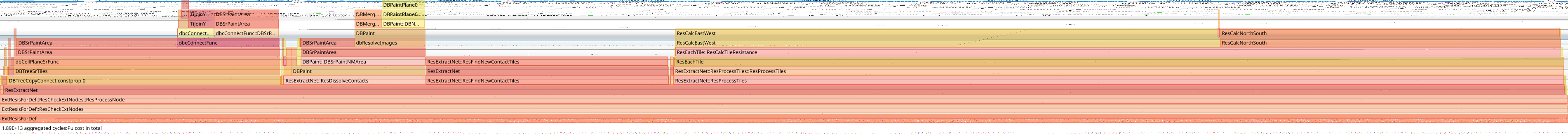

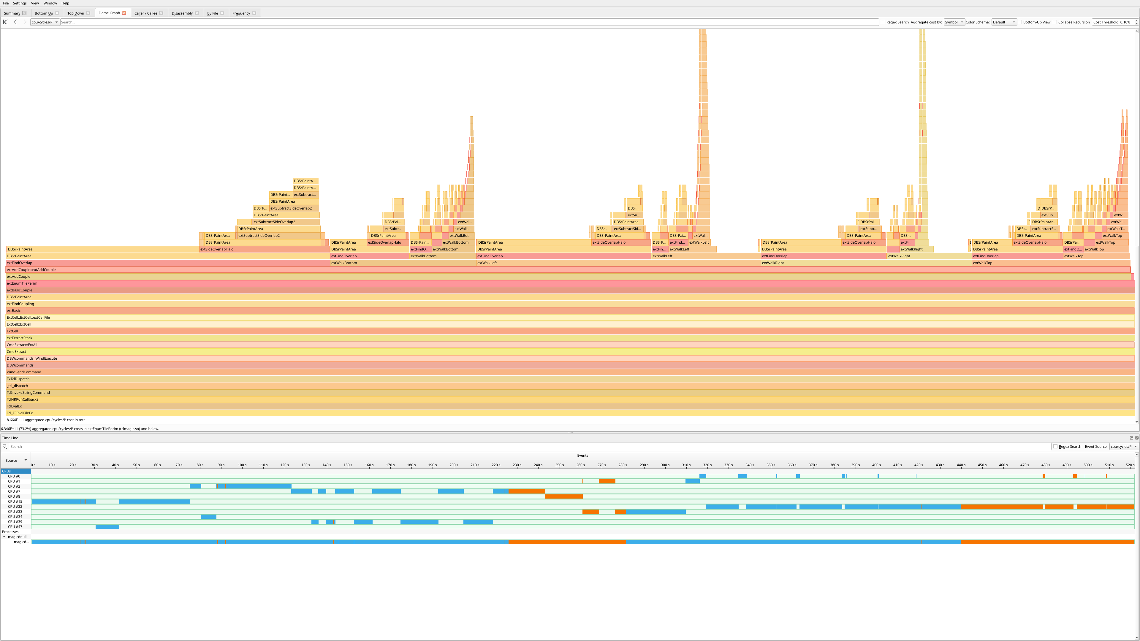

So, we're in luck, I managed to get frame pointer and debug symbols compiled in for a build of 8.3.645 and am running on tinyqv_quarter_label_flattened_01.gds (and I choose a cutoff of 0 for the capacitance as that happened only later and I figured I'd rather get this done now and let Xyce worry to possibly threshold that rather than erase the smaller capacitances ahead of it when magic writes out the extraction in the desired spice netlist format) currently with a cycles perf record running with stack tracing using said frame-pointer's; I confirmed it works nicely in KDAB's hotspot for me. Might have to adjust source file search path I guess, will see in a bit. Figured I'd upload the gds and also the edited but not yet flattened gds here, as they're small enough when compressed.
22:38
At the current growth rate of the perf recording I've got about 7 days until the SSD is filled up; but as this is compressed and contains stack traces it will be vulnerable to changes in data rate as the process stages changes.
💯 1

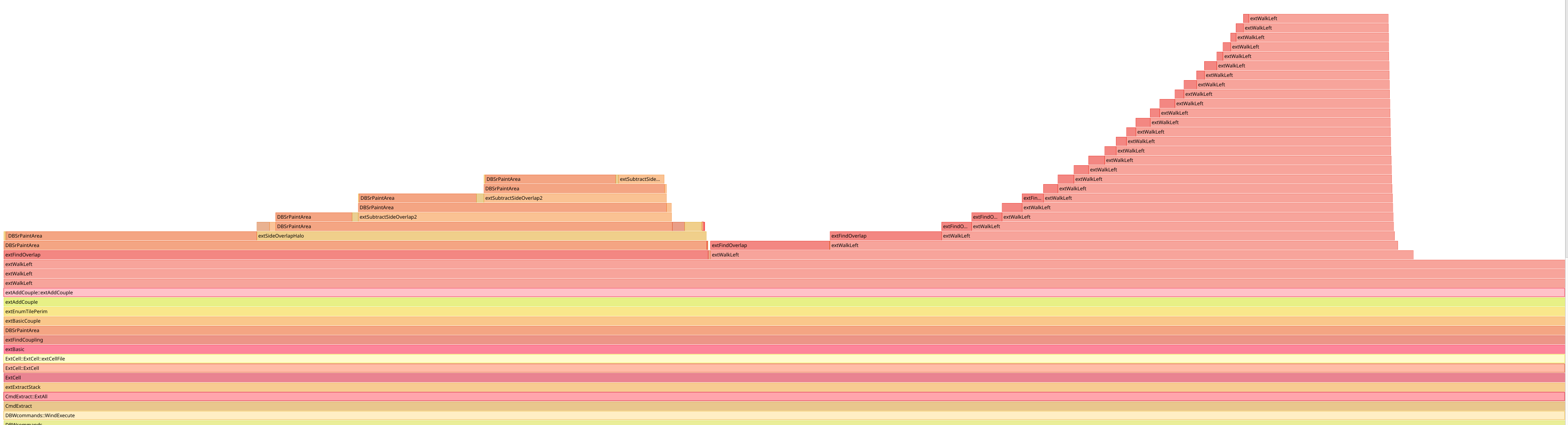

for your pleasure/sneak peek; a short second recording done while it was running:

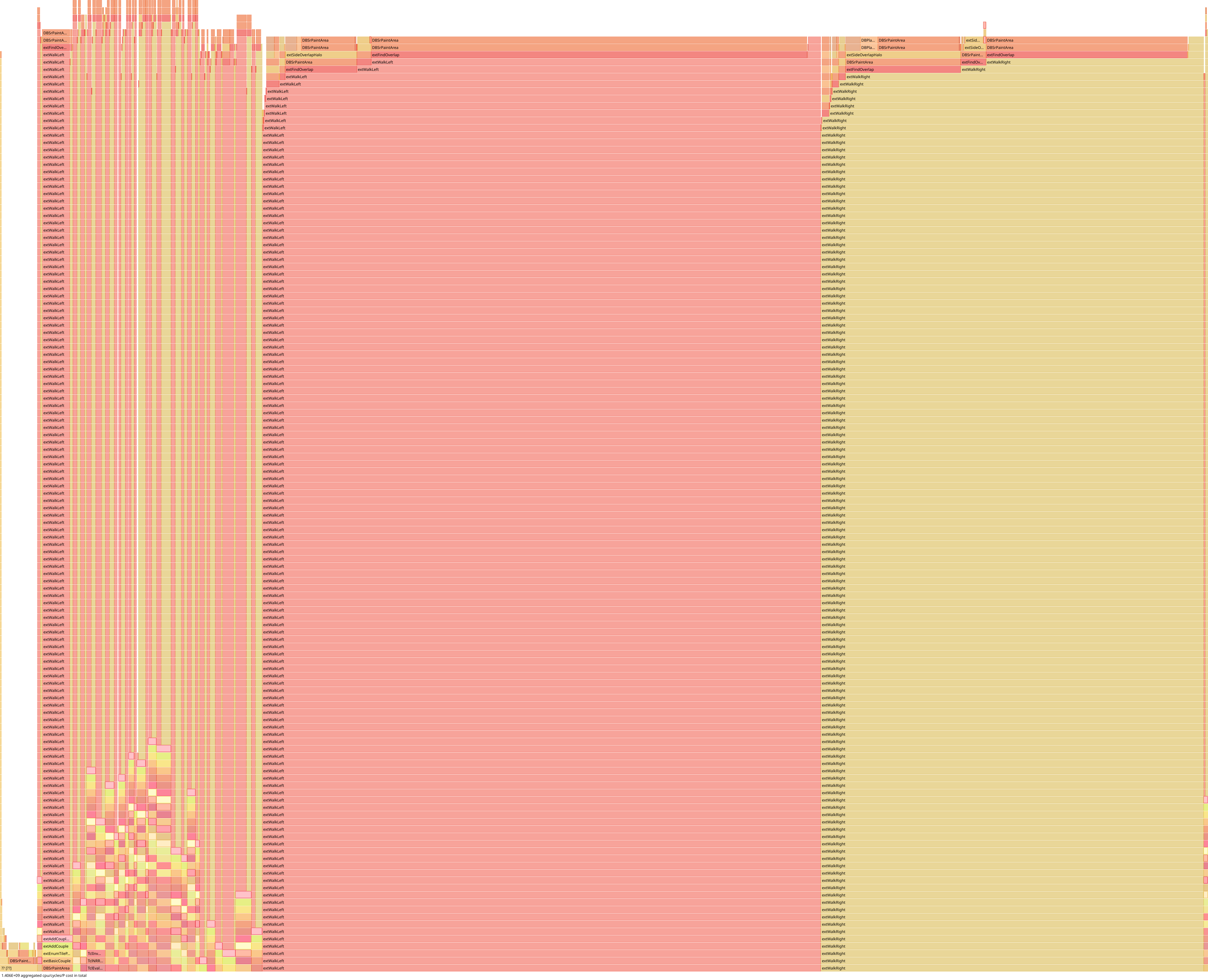

22:52
flame graph filtered down to extEnumTilePerim (tclmagic.so) and below.
22:54
the blue timeline sections are the non-hidden flamegraph content; i.e., in the orange timeline sections it was doing not extEnumTilePerim
22:55
notably it was doing extBasicOverlap instead of extBasicCouple (the latter the direct parent of extEnumTilePerim).
22:57
@Tim Edwards if you want I'll give you the profiling result from this run when the run concludes; though for reasons of possible contamination with trace amounts of personal data that one won't be public data (I don't think it has gobbled up any of that, but it's hard to rule out).

I'll have a good hour or two of profiling right in the middle of vss net resistance extraction (and probably going on to vdd or whatever nets it chooses next) for the last of the 4 GND bond pads to look at after a brief nap, though not for too long sadly, before I have to go to the office and do $dayjob things. At this pace I do have hope that the extraction will finish within the next 24 hours and I can then get the files dragged together for you to enjoy the profiling recording of the entire run on the 0.5x0.5 TinyQV flattened gds. I think there was some tool to bundle all the files needed to make unwinding work for you, but I'm sure I'll find a decent way to make it viewable in KDAB's hotspot for you (including decompilation view!) until then. I'll plan to send you a .tar.zst and necessary instructions for how to feed the data to hotspot via wormhole as discord DM; let me know if that's a problem.
Also I don't know if you've heard of it before, but as far as attaining a quantified and attributed understanding of malloc-spam goes, KDE's heaptrack (from the same author as KDAB's hotspot) has done wonders for me when I used it on some photogrammetry/structure-from-motion toolchain TU Darmstadt's MVE. Small commits like https://github.com/namibj/mapmap_cpu/commit/54076e35bc99ae882672e91b28b8308d681898e7 (heaptrack), https://github.com/namibj/mve/commit/09c252dea56d2e4d78993ee6e0fc5663821d8509 (hotspot), or https://github.com/namibj/mapmap_cpu/commit/fc6ea70ddccfc08f0768cf6f530fe13d179f88ad (iirc this one was highlighted by heaptrack for suspicious allocation intensity, then hotspot was used to get a quantified understanding of how bad it seemed to be to try and estimate how much whole-program speedup could be reasonably expected to be attained, before I looked for a suitable (smol, easy, compatible licence) concurrent union-find library to "easily" vendor into the project and swap out the BFS implementation of the connected-components task for a union-find one. See below for excerpt of the changed file that should make obvious how this kind of problem could be surfaced by heaptrack.), are representative of the impact I managed with those 7 years ago. /** * A complet contains a partial component: a list of node, its temporary * component ID and the ID of seen other complets */ using complet = std::tuple<std::vector<luint_t>, luint_t, std::set<luint_t>>; tbb::concurrent_vector<complet> accrued_complets;
A heap memory profiler for Linux
09:16
This is from two big nets (must be one or two vss and one or zero vdd); I filtered carefully but limited by pixel-perfection to the time range of these two among the over 4 hour long perf record's recording. It's CPU cycles spent while executing the process in user mode.
09:17
the txt is what it calls "stack collapsed" export.
09:17
The 3 files are otherwise all from the very same filtered view.
09:20
that's after 9h35 min of CPU time on the process.
09:20
(I just re-used the local PDK copy from the other (the large) chip.) (edited)

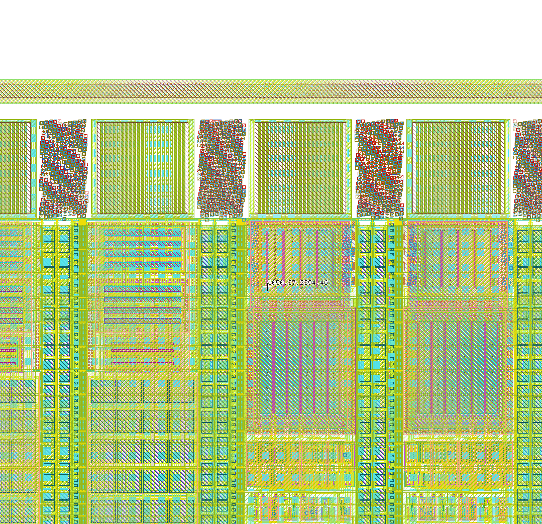

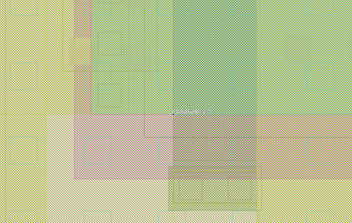

bad news: it crashed at the end. good news: it appears to have finished at least almost all steps.
16:03
16:03
16:04
16:07
That looks like it may be the Bad Device Location at 210074,478892; it lines up nicely with what seems like it could be a device's bottom left corner, and has that 5/1 scaling applied that magic spoke up at the beginning of the log.
hotspot 1.6.0; the .perfparser pre-digested recording comes soon. It's processing.
16:20
(It looks to be taking about 20 minutes to process through /usr/libexec/hotspot-perfparser)
Tim Edwards 05/21/2026 21:32
Meanwhile I worked around the issue at ResMakeRes.c:397 with a hash table so that it can convert nodes on the main pass through the linked list instead of running a second loop through the rest of the list to search for nodes that need converting. This time I will run on your quarter-size chip so that I can see results by the end of the day, maybe, and also take a look at that crash condition.
