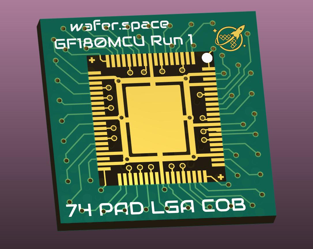

@J-Lo - Reevaluate your life choices? ๐Ÿ˜‰ (But seriously, QFP chips have lots of issues). There are a bunch of examples at https://github.com/wafer-space/chip-on-board-wire-bonded-pcbs which make it easy to mount your chips on your own PCBs using connectors.
Wire bonded chip on board PCB designs. Contribute to wafer-space/chip-on-board-wire-bonded-pcbs development by creating an account on GitHub.
21:13
The wafer.space community is developing a flexible chip-on-board packaging strategy, so you won't need specialized equipment or expensive packaging services to use your chips.
