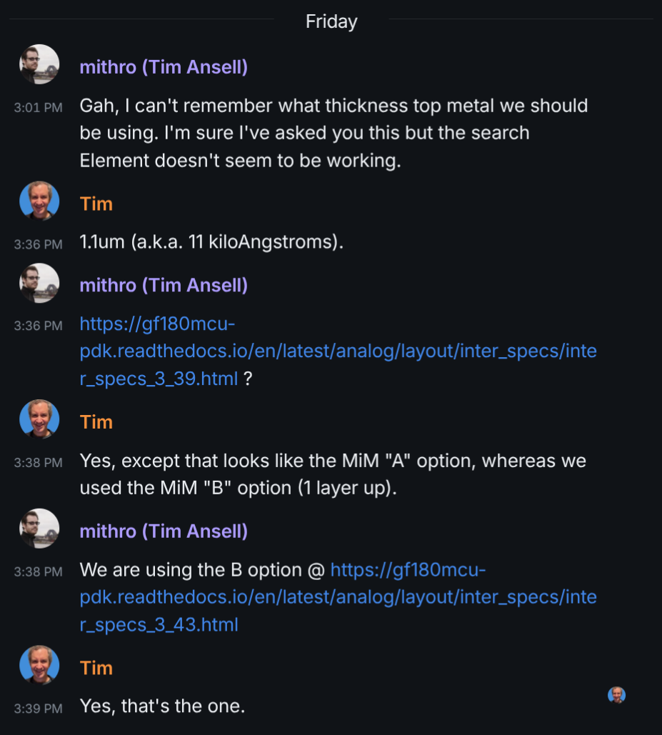

What's the top metal layer thickness in gf180mcuD ? I though this was the Top metal (30kA) but looking at the tech lef, it doesn't seem to match any of the available option.
From https://github.com/RTimothyEdwards/open_pdks/blob/master/gf180mcu/NOTES: "February 14, 2023: Added PDK variant gf180mcuD, which is like gf180mcuC except has a top metal thickness of 1.1um instead of 0.9um. According to GF, this is preferred for better wire bonding yield on the pads. The first open MPW was done with gf180mcuC, but all subsequent open MPWs will be done with gf180mcuD."

1.1um (a.k.a. 11 kiloAngstroms).
10:38 p.m.
Guess that should be published somewhere.......
A bit unfortunate that it's the "B" option because MiM won't be available in TT (user don't have access to the top metal layer, so they can't contact the top plate), but "c'est la vie".
